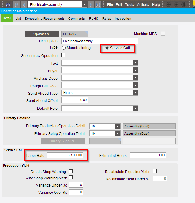

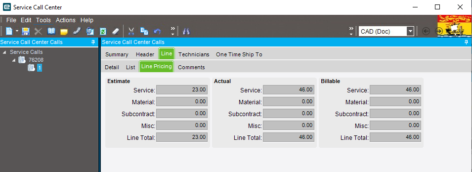

A couple of things to keep in mind. The operation on the service job should be of the Service Call type. And you may or may not want a Labor Rate for estimated vs actuals.

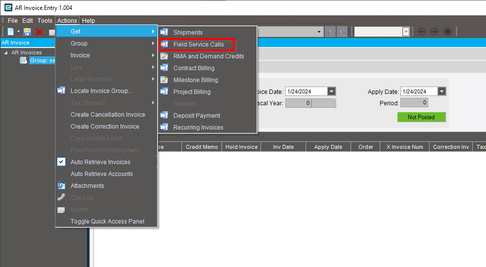

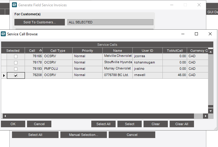

After labor is issued to the service job and the call gets closed create your invoice group and select Field Service Calls from the Get actions menu. This will create your invoice.
Thank you for the replies, I realized my mistake. When I set up the Service Call I pulled the information from the pack which apparently checks the boxes for labor and materials. That caused the ‘billable’ fields to be empty which then caused the invoice not to create. After a few days I think I can say I understand the process enough to generate an invoice.
