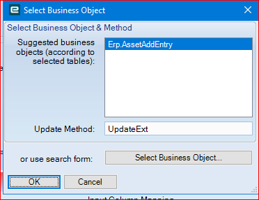

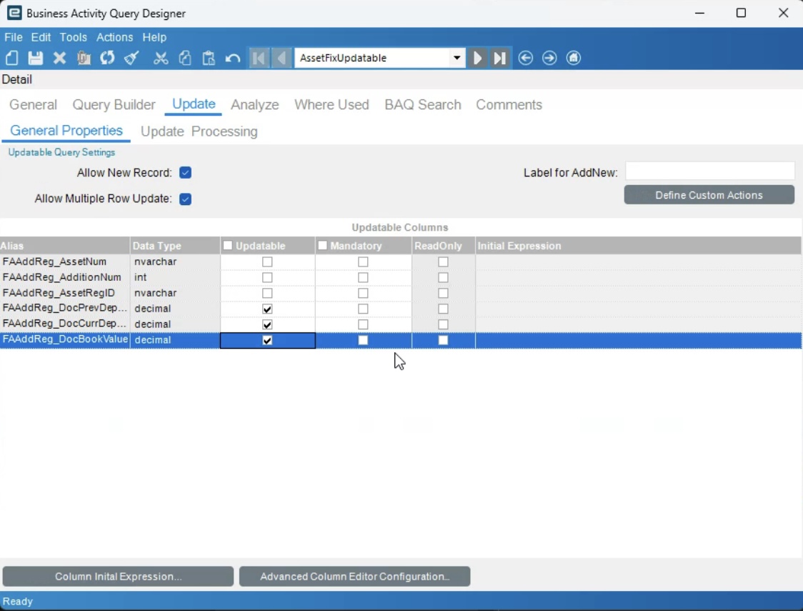

I am trying to create an updatable BAQ on the FAAddReg table. I just want the bottom three fields in the image to be updatable but cannot find a business object that can do so.
Also curious if I need to update any fields besides the “Doc” fields. All of our assets should be priced in USD. Should I be updating CurrDepreciation and DocCurrDepreciation, for example?

If you have FA licensed the Business Object should show you AssetAddEntry.
you will also need to include FAAddition table and all of its keys.
Weird. I thought I tried that but you’re correct it does look like it works. Thank you!
