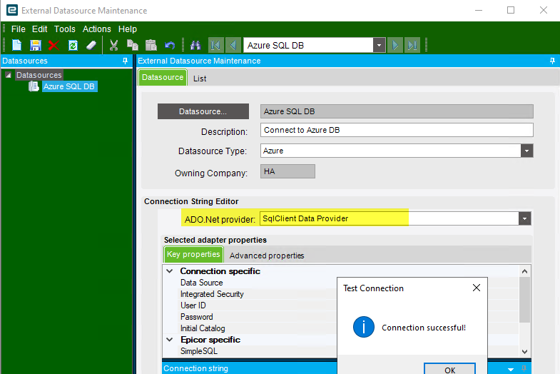

What I do not understand is that the external datasource uses the SqlClient Data Provider – so if that is the case, why did Epicor block the ability to use these external DLLs.

Let me clarify that this in on-premises and not cloud. Also, the forms will most likely never be converted to Kinetics forms.
I am aware that there are technically better ways of doing this like a webservice API, but for now I just would like it to work like before without a complete re-write. Thanks, but no thanks Epicor for wanting to “protect us” but we can control security internally with permissions and firewalls.
