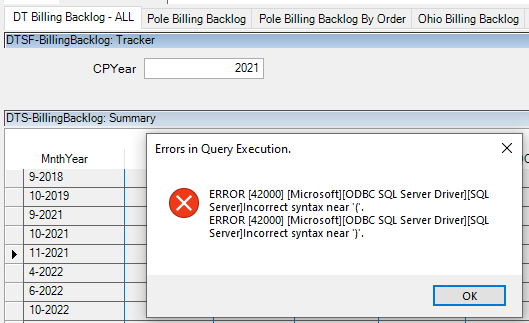

I have attempted to create a tracker on an External BAQ Dashboard with no success. I get this error
when refreshing Dashboard with a value in the Tracker field for CPYear.
Here is the Tracker Properties window:
I did read where I should try hiding the Tracker default field and using Toolbox to insert a Numeric editor filed in Customization Tracker View. It also did not filter.
Anyone have a suggestion on how to find what is causing this error?
Just an update to clarify, this error only pops up when the CPYear tracker numeric editor field has a value in it.
Thanks for your time in advance!

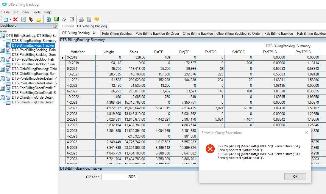

@Miker I would check back in the BAQ for calculated fields that need to be wrapped up in parens and add a Param for testing of CPYear there before going to a dashboard.
