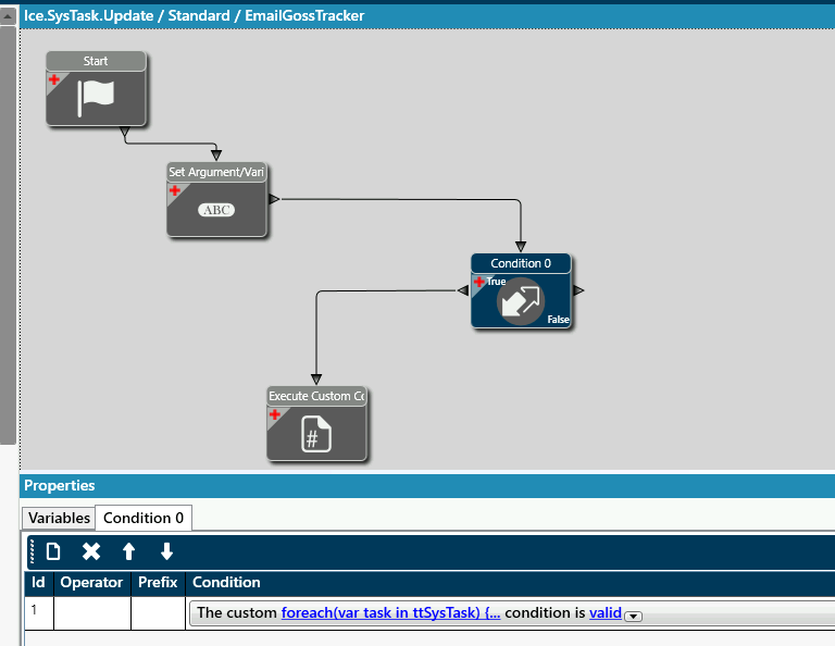

Just remember you can already use baq export so it would be possible programmatic ally call that service from a bpm…
That may simplify things. There are also examples on posts here for generating bartender labels which would get you pretty close.
This is what I’d do. Recreate the grid in a BAQ, schedule the BAQ, then have a BPM email the BAQ export to the customer whenever it triggers. I have a dozen of these active, I’ll share the BPM diagram/code once I get to a computer
Actually, looks like I’ve already posted it
