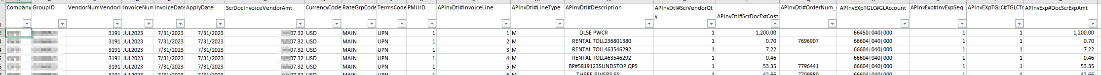

For our credit card transactions, we use a Comdata corporate card, which provides us an Excel report. We massaged that into a format that lets me DMT it monthly into the AP Invoice Combined template. Takes a few hours for 500-700 lines, but it’s a smooth process. We do one invoice with 500 lines on it with Comdata as the vendor.
