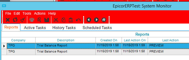

Oops, right in front of me SMH
That causes Excel on your local machine to open with the data generated (and stored) on the App server?
I would have thought that would still try to launch Excel on the App server (or wherever the Client is running)
Copy to excel is grayed out when Excel is not installed. Also if excel is not installed it will not auto pop up. They will be instructed to go to the system monitor and save the report, which gives them an excel file to copy down and run on their local machine
