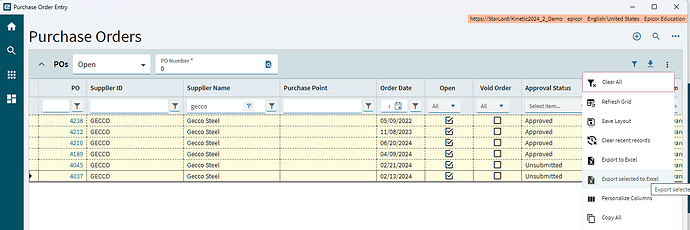

Apparently there is a new feature in 2024.1
So:
  • Add Filters
  • Select the rows
  • Overflow “Export with Selected to Excel”
