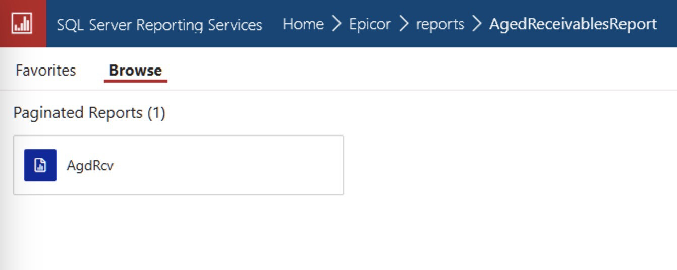

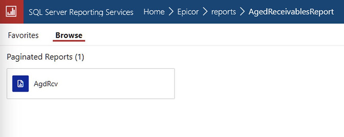

I’m starting to think that the issue we are having is that ARPromissoryNote doesn’t exist in the Aged Receivables report folder:
Since the error mentions that and not an _ExcelData RDL missing, maybe that’s really what we are running into.
After I made some security fixes in the SSRS folders, it seems like I CAN run reports with Excel-Data Only, it’s just the Aged Receivables report that isn’t running with that now. Maybe there should be ARPromissoryNote in the folder along with AgdRcv?
