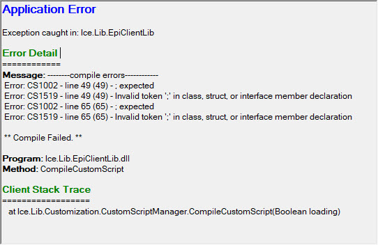

  1. attempt to automate the Save button on the ConfigurationRuntime Entry. That window is from the Configure Button on the SO detail tab. for whatever reason, I can not put a customization on that module.
    ProcessCalling
    When I open it in developer mode and select the Base Only checkbox, I get a compiling error.
    Application Error
    If I don’t have the developer mode on, then all is good. I have tried to save a customization and I can not remove the compile error. That is without adding anything to the customization.
