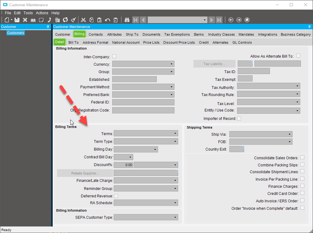

Hey Darren,
We do use Epicor to handle our billing schedule and charge codes, if I understand those words correctly. Forgive me if I am totally not understanding what you’re asking though! :wink:
Billing Schedules, if I am understanding it, would be Billing Terms in Epicor world. This is configurable on the customer level.
