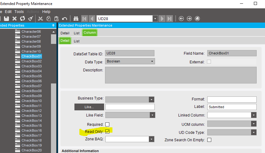

Once again I was making it harder than it needed to be:
