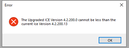

I have just installed the RL11.2.300.0 and UD UD11.2.300.9 patches in my environment. I would like to only update my Pilot environment for now to test some of the new features before I start using it in production. When I go to Database Server Management>MyServer and right-click my KineticPilot environment, then click Upgrade Kinetic Database, I get the attached error:
I belive it’s saying the DB is at 4.2.200.13 but your app server is at 4.2.200.0. You would need to apply the .13 patch to your appserver and redeploy.
If you have just applied a patch then you do not need to run the Upgrade Database option in the Epicor Administration Console, just upgrade the Application Server.
When you run Epicor for the 1st time after the Application Server has been patched then you will get a prompt to run a d/b upgrade and then the conversion workbench
