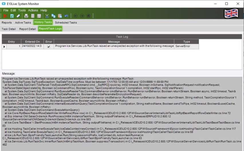

My client has a problem when printing certain SO Acknowledgements;
Program Ice.Services.Lib.RunTask raised an unexpected exception with the following message: RunTask:
System.Data.SqlTypes.SqlTypeException: SqlDateTime overflow. Must be between 1/1/1753 12:00:00 AM and 12/31/9999 11:59:59 PM.
