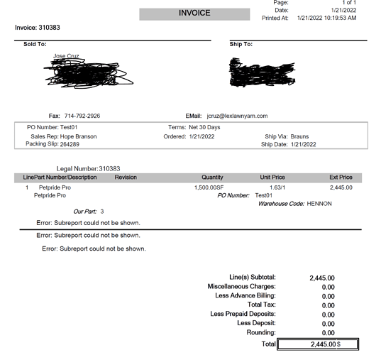

Hey guys I created a new report style for the ARForm. The purpose of this is to use it with a BPM that will email out customers their invoices when the invoices are printed form the Group. The BPM and email blasts are working just fine. To avoid any problems with the standard ssrs report I created the copy of the report style and modified added a table to the new report style (needed an additional field). I copied the report and placed it in my custom report folder in our SQL reporting services. The report comes up just fine but on the bottom left side it has the Error: Sub Report could not be shown three times.
I looked at the log files in Sql server and found the following:
e ERROR: An error has occurred while processing a sub-report. Details: Data retrieval failed for the subreport, ‘SubRptLineMiscCharge’, located at: /Epicor/reports/CustomReports/SalesOrderAcknowledgement/SOForm_OLMscCharge. Please check the log files for more information. Stack trace:
at Microsoft.ReportingServices.OnDemandReportRendering.SubReport.FinalizeErrorMessageAndThrow()
I assumed I was missing that report in the custom folder but SOForm_OLMscCharge report that is referenced in that line is also copied into the custom reports folder under the sales order acknowledgement folder. I’m not sure where to go from here. Does anyone have any insight?

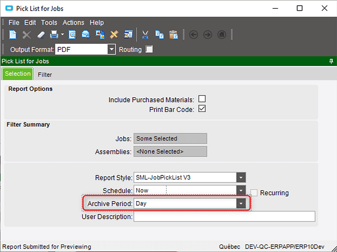

  1. Set an archive period in the print form

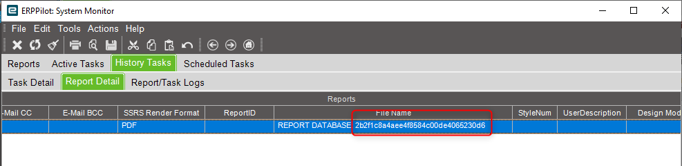

  2. Preview the report then open System Monitor. Find the report and access the Report Detail tab. Scroll right and you will find the report GUID

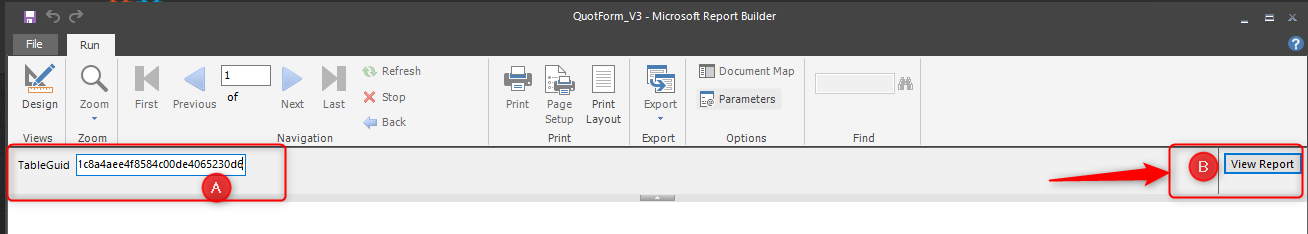

  3. Open the report in Report Builder and click RUN
  4. Enter the GUID in the parameter textbox. Your report may have other parameters as well, just enter the required values. Then, click on VIEW REPORT
