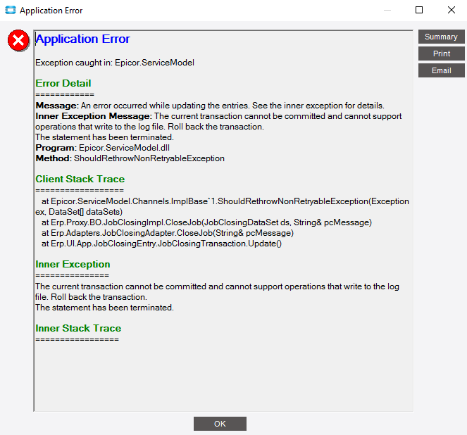

This is driving me crazy, and I can’t find the fix. I create a job, time went by, and I want to delete it. No transactions have been done to it. I need to remove the demand link, so I un-engineer the job. When I click the engineer checkbox to un-engineer it, or the complete checkbox in job closing, I get this error:
It will then reset the job back to engineered, or not completed. Hence, I am stuck with a job that I cannot delete, and cannot close in the system. It is not the biggest deal, but it really bugs me that I can not remove it from Job Manager, and it will always be there as an option. Any idea on how I can fix this? It has only happened to me a handful of times.

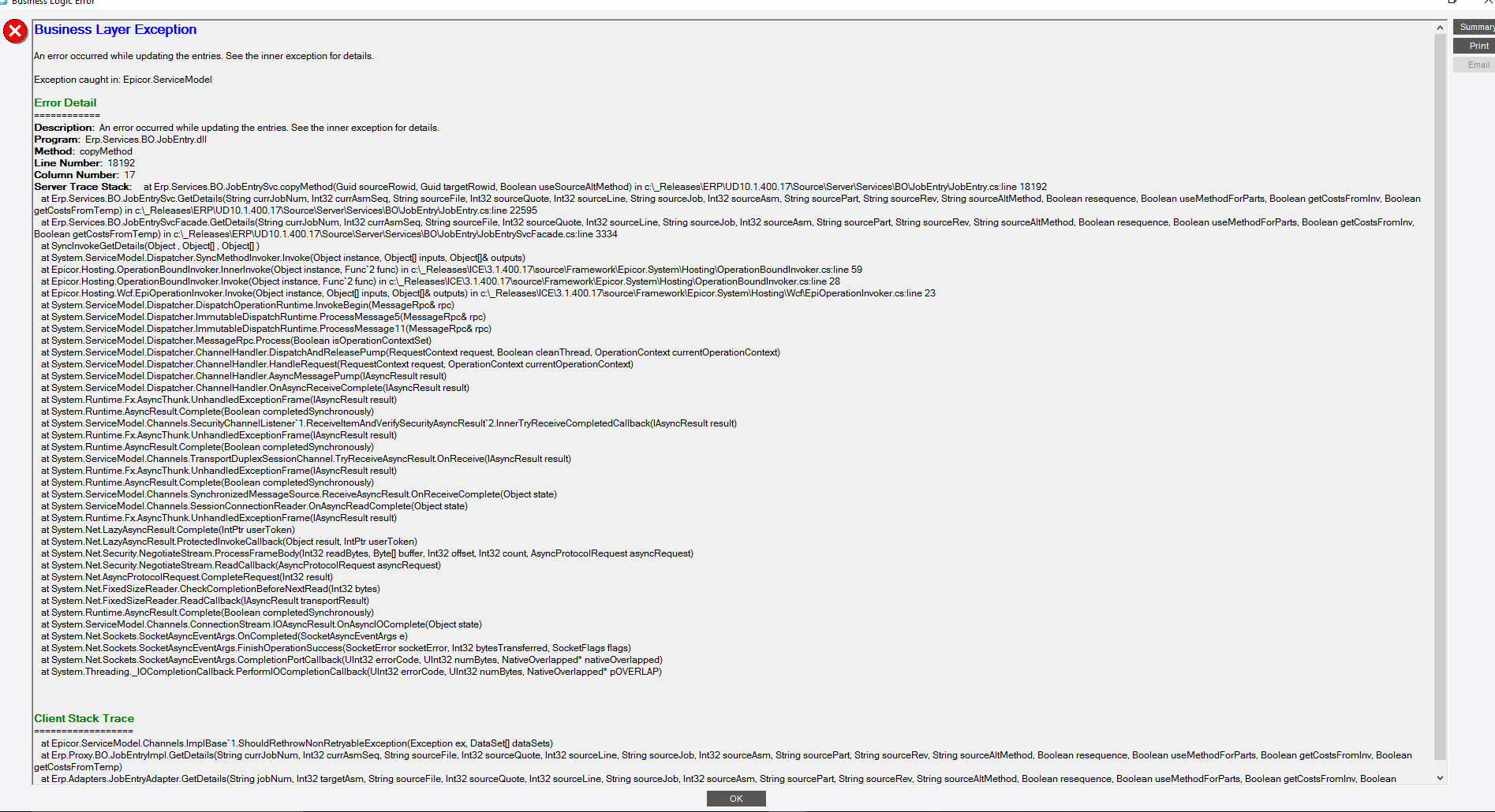

The plot thickens. I am trying to create a new job with the same part#. When I go to get details, I get an error, and nothing is pulled in. I am pulling the details from part/rev. The revision is approved, and doesn’t appear to have an errors.
Looks like somehow this has to do with the part#???

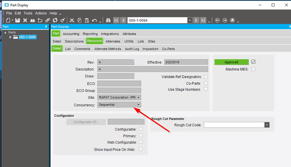

Absolute shot in the dark, when you go to that part number in part entry and go go the active revision, does the concurrency say sequential? We’ve has some issues with release jobs where that gets cleared out for some reason. It’s a slightly different error which is why I doubt it is the problem, but heck maybe?

Tracing was turned off. I cleared it. I turned it on, still nothing. Is there anything specific I would need to do with it?
Nope. That would be it.
