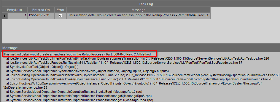

Error in Rollup - This method detail would create an endless Loop
Our engineers are getting “endless” loops when doing a cost rollup in Epicor. I believe that this is caused be an Assembly part number at the parent level, being called out at lower levels causing the rollup process to “loop” upon itself.
The error does give the offending part number in question.

I am actually running the “BOM Cost Report”
The “detect redundant BOMS report” is a utility that the “IT” folks usually run…. It won’t be in the standard menus.
So, The error that I sent is from the “BOM Cost Report”

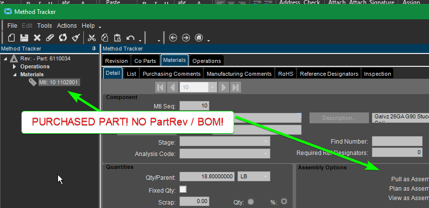

Has anyone ever seen this where you have a relatively simple BOM (maybe 4 layers deep, but only the top level or 2 are very “wide”) and have searched the BOM unable to find any loop?
The error message seems to indicate a sub-assembly as guilty (611034), but that part has only a single, purchased part on it’s own BOM!
This method detail would create an endless loop in the Rollup Process - Part: 6110034 Rev: - AltMethod: .
   at Ice.Services.Lib.RunTaskSvc.InnerRunTask(Int64 ipTaskNum, Boolean suppressTransaction) in
   C:\_Releases\ICE\3.1.500.14\Source\Server\Services\Lib\RunTask\RunTask.cs:line 526
