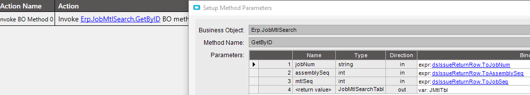

Here is where it gets a bit crazy. IssueMaterial doesn’t have Operation of any kind and I need to see if the Operation is complete or not. It is only the MtlSeq via JobMtl. So, I figured a Function, but that doesn’t really work.

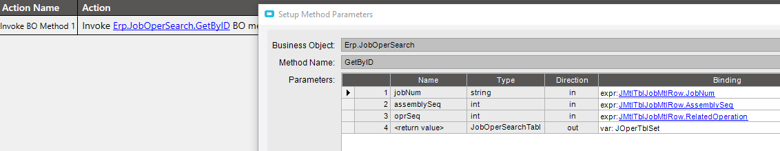

So I tried if tranqty changes then invoke JobMtlSearch BO, as I can link that to IssueMaterial. Aft that I invoke JobOpSearch BO. That worked fine, as I set it to send me an email with all the info. works perfect.
Lastly, IU put in the final condition, JobOper.OpComplete if the changed row is equal to true. This is where it breaks. It just doesn’t work.

Here’s some pics…
Condition 1
Linked to JobMTL
Linked to JobOper
Linked to Condition 2
Linked to Error Message
