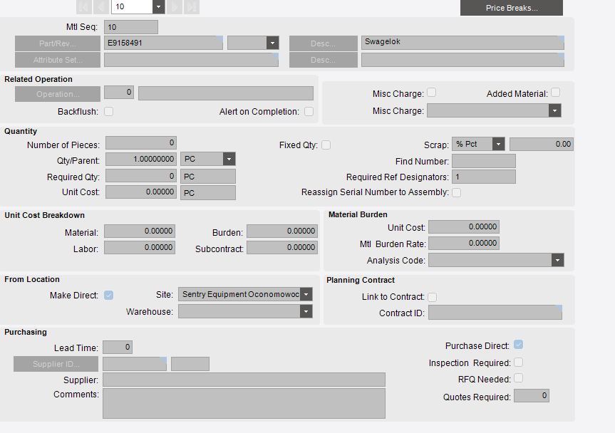

Error executing Job's Engineered
I get this error when I execute Engineered job
Assembly 0 - Material 10 for Job RWCT9130285 does not have the required quantity of Reference Designators.
Error Detail
Description: Assembly 0 - Material 10 for Job RWCT9130285 does not have the required quantity of Reference Designators.
Program: Erp.Services.BO.JobEntry.dll
Method: validateReqRefDes
Line Number: 41845
Column Number: 25
Table: JobMtl
Client Stack Trace
at Erp.Proxy.BO.JobEntryImpl.Update(JobEntryDataSet ds)
at Erp.Adapters.JobEntryAdapter.OnUpdate()
at Ice.Lib.Framework.EpiBaseAdapter.Update()
at Erp.UI.App.JobEntry.Transaction.Update()
Thank you so much have a nice day :thinking: :thinking: :thinking:
On one of the parts on a the job Require Reference Designators was checked true. This can be flagged in Engineering Workbench or on the fly from a job. I would look there.
