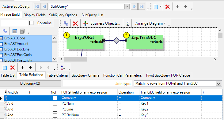

Hey there, I think you need the TranGLC table. This is how it joins with PORel:
Also, for the TranGLC table, you need criteria where TranGLC.RelatedToFile = PORel

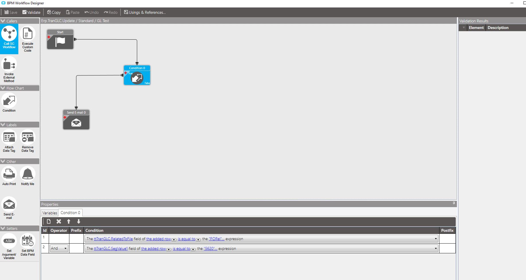

Thanks for responding. My original intention was to show a message on the PO Dashboard if it was tied to our 5620 account. However, I’m not sure how to bring the TranGLC table to the PO Rel Standard Data directive to check against the GL account and generate the message. I got around this by creating a SDD on the TranGLC table (that you show in your query) that sends an email when a new row is created with the 5620 SegValue. Below is the condition I used to validate.
The email works just fine but it is not an instant message that pops up on PO Entry (which I would much rather have). If you know how I can accomplish the message on the PO side please let me know.
