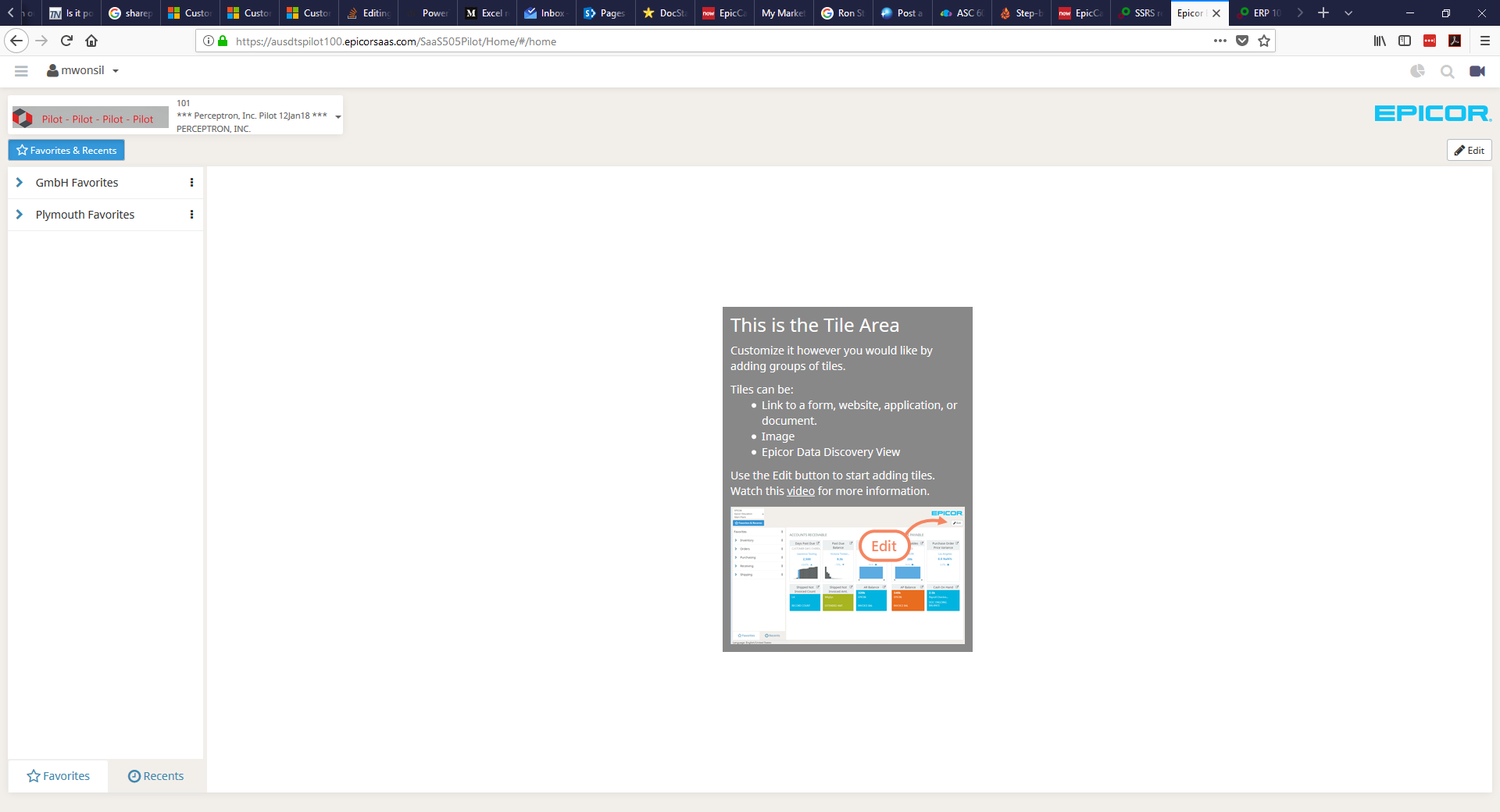

What I have seen, and we’re DT SaaS users here, is there is actually a URL that you can go to outside the Epicor Client that shows all of the same information. We’re not using it yet but I’ve played around with it in our Pilot environment. I assume that the drill-down is all there since the EDD product is entirely written in HTML5 - so it’s available on mobile as well.
