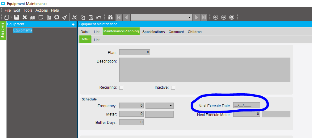

Try to update the “Next Execute Date” to the required date once the job is closed.
But we don’t want to update it manually every time we close a job.
