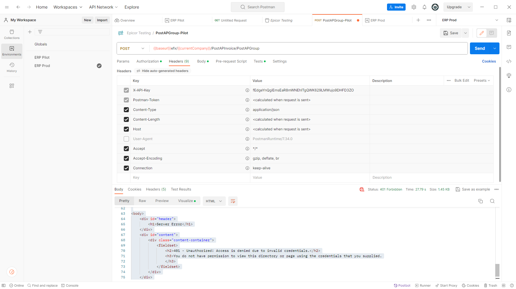

EpicorRESTApiCore - Error when running POST
Above is the header being sent
You got no auth header. Need a bearer token or basic auth. The key only provides access scope not auth

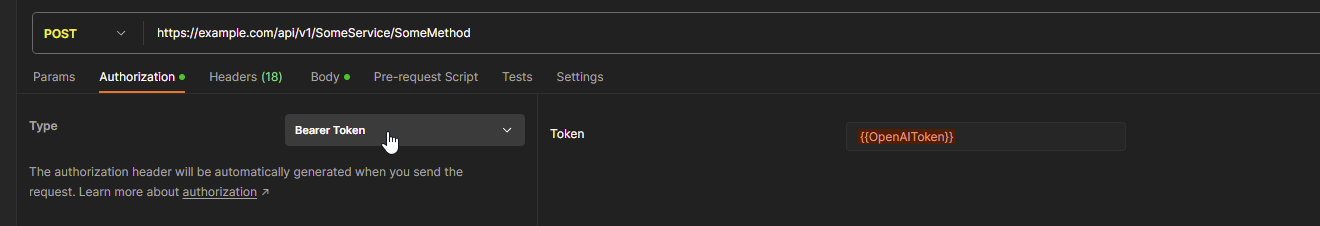

Joshua, if I add Basic authorization in Postman with my Epicor manager account and password, the X-API-Key in the header vanishes, but I get a 403 error saying REST calls must pass a valid API key. Where do I add the API key to the request? As an additional key/value pair in the Postman Headers section, or Body? Postman automatically adds the Authorization to the header when sending.

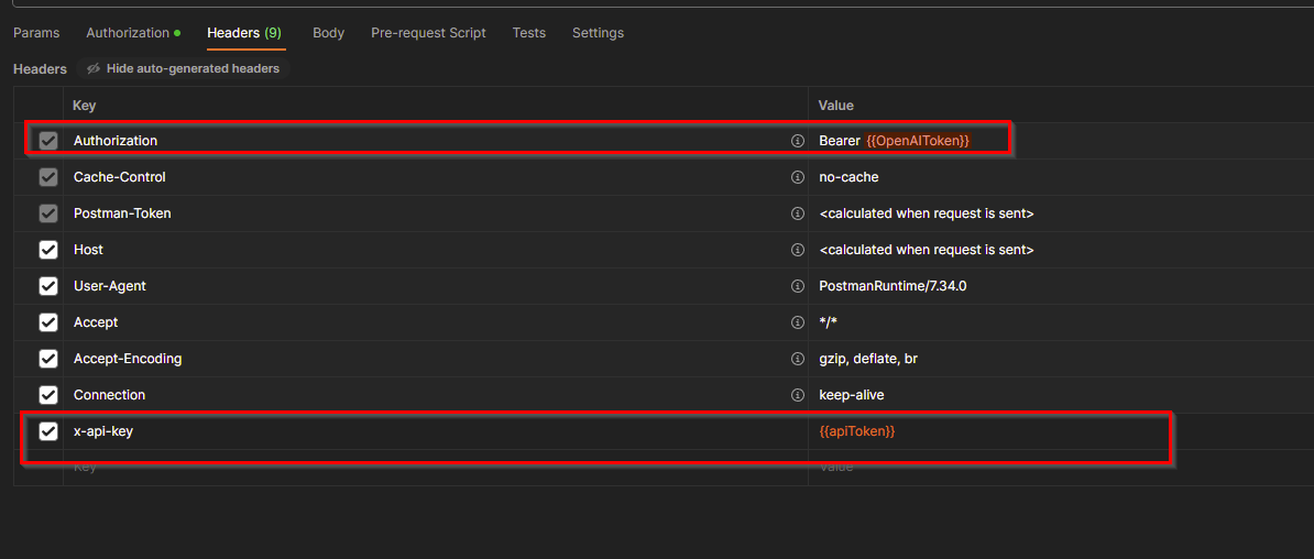

Authorization should look like this with Bearer or Basic
Then you add the API to headers manually
Thank you, Joshua! I finally got it to work, posted a batch successfully thru Postman!
