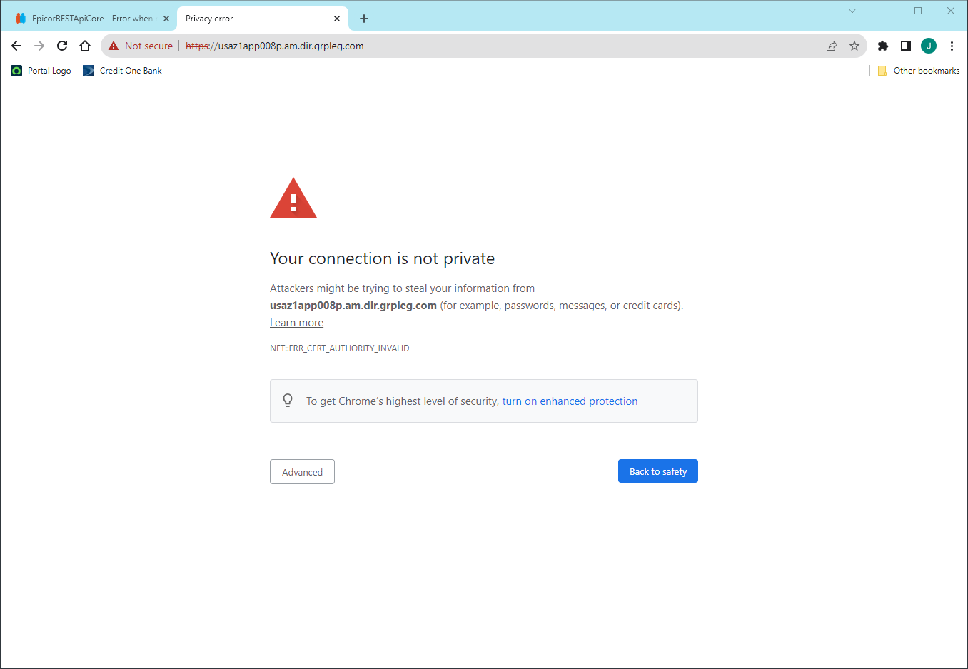

Jose, could this be happening due to the server using a self-signed certificate? I get the following if I go to the server address in Chrome:
There’s a bypass bad cert flag
No the Host should just be the TLD the AppPoolInstance would the your Epicor Instance name

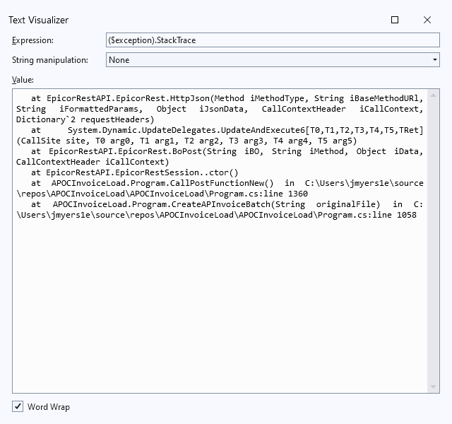

Jose, here’s the error:
System.MissingMethodException
HResult=0x80131513
Message=Method not found: 'Void RestSharp.RestClient…ctor(RestSharp.RestClientOptions, System.Action1<System.Net.Http.Headers.HttpRequestHeaders>)'. Source=EpicorRESTAPICore StackTrace: at EpicorRestAPI.EpicorRest.HttpJson(Method iMethodType, String iBaseMethodURl, String iFormattedParams, Object iJsonData, CallContextHeader iCallContext, Dictionary2 requestHeaders)
at System.Dynamic.UpdateDelegates.UpdateAndExecute6[T0,T1,T2,T3,T4,T5,TRet](CallSite site, T0 arg0, T1 arg1, T2 arg2, T3 arg3, T4 arg4, T5 arg5)
at EpicorRestAPI.EpicorRest.BoPost(String iBO, String iMethod, Object iData, CallContextHeader iCallContext)
at EpicorRestAPI.EpicorRestSession…ctor()
at APOCInvoiceLoad.Program.CallPostFunctionNew() in M:\IT_Volume\SourceCode\CSharp_102700\APOCInvoiceLoad\APOCInvoiceLoad\Program.cs:line 1427
at APOCInvoiceLoad.Program.CreateAPInvoiceBatch(String originalFile) in M:\IT_Volume\SourceCode\CSharp_102700\APOCInvoiceLoad\APOCInvoiceLoad\Program.cs:line 1084
This exception was originally thrown at this call stack:
[External Code]
APOCInvoiceLoad.Program.CallPostFunctionNew() in Program.cs
APOCInvoiceLoad.Program.CreateAPInvoiceBatch(string) in Program.cs
I’m using EpicorRESTAPICore 2.2.0.2

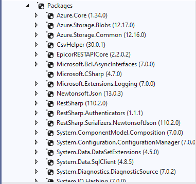

If your project is targeting .NET 6 you should use version 2.2.0.2 of the library which should automatically install Newtonsoft 13.0.2 and RestSharp 108.0.3
I already have the versions you listed or higher…
That’s the wrong version of Rest Sharp.
OK… Switched RestSharp versions to the correct one(108.0.3), I’ll try it and let you know
