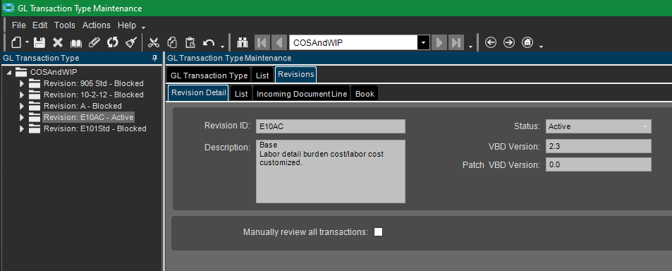

Here is our COSAndWIP in Epicor 10.1.500.14:
In the past, you’d see all of those revisions blocked and there would be a new revision - kind of the base rev for the new version - that would be active. But this time it seems in Epicor 10.2.400 that our active revision in 10.1.500 is already marked as active in 10.2:
And if I look down at the few customized rules, they seem to already have the custom logic in them:
Cool, even seems like E10.2.400 has an indicator for which rules have been customized.
But maybe I need to worry about the fact that now there is a “Customization” tab - or maybe by just using this revision straight out of E 10.1.500 we’ll somehow miss new features or bugfixes added to 10.2.400? I am guessing not, since I did an XML export on both versions and compared and they are very different throughout the whole export.

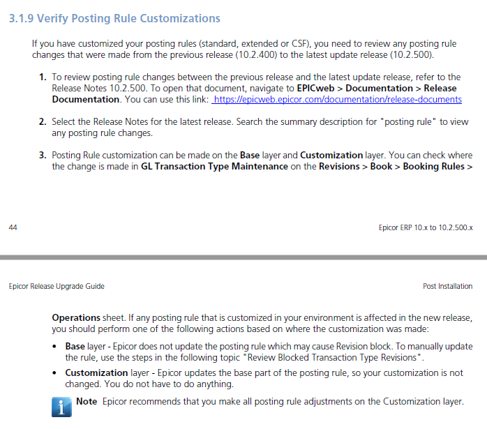

It is in the “Epicor Release Upgrade Guide, Epicor ERP 10.x to 10.2.500.x”, in section 3.1.9. I was looking at this yesterday.
I am very interested in both of your experiences. I’m deliberately doing an upgrade to 10.2.500 (tonight, actually) before modifying posting rules, to avoid the heartache. It will be the first time I have actually modified rules in a live database.
The guide says do the mods in the customization tab, but I have experimented only with Base because it makes more sense to me to put my logic in the middle where I need it. I don’t have confidence how Customization mods are executed. I think in testing it wasn’t predictable enough for me to use the Customization layer.

We also used Base for our custom Posting Rules. As noted by @Noffie I don’t think the Customization tab was even there in earlier versions and it certainly doesn’t seem to work in the same way. So far our custom rules have come with us from 10.1.400 to 10.2.500 done in Base, so hopefully they’ll keep going a while longer in spite of Epicor’s recommendations.

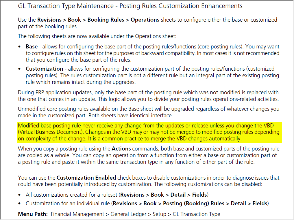

It does make me wonder (nervously) if there might not be new “features” or bugfixes we’re missing in those rules - like are we locking those rules into what they were in 10.1.500 with our customizations forever because they are “base” customizations now?
So, I just had the thought - I should go search through the FeatureSummary documents for each version between our current 10.1.500 and 10.2.400, and I found this in the summary for 10.2.100:
That highlight is mine, and seems it may be validating my concerns? I am at a loss as to what a Virtual Business Document is though. Can anyone translate this text?
