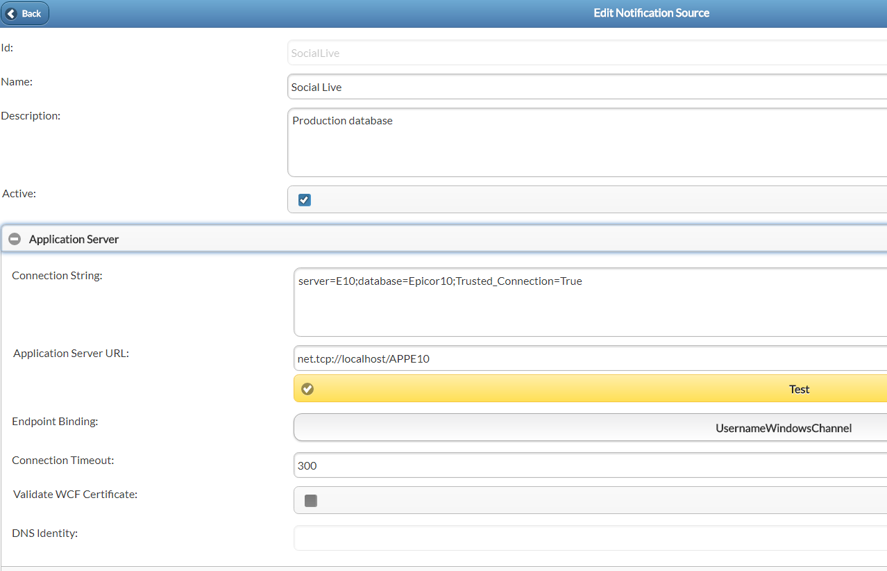

I have installed social enterprise, but after creating source id , it is not created and appeared in list.
screenshots attached.
any setup is missing ?

Hello Prakash,
I am just getting started with Social, and I’ve installed 10.2 in prep for go-live in a couple months. The product installed quite easily for me, but I did have to play with the connection source settings (connection string, etc.)
Did you try recreating the source and verifying it (Test button) while still on your screen? It also looks like there’s a checkbox to make sure its active.
From there, I would check the app server and use custom accounts (CDC Service, etc.) - ones you know have access to the DB.
Thanks for the quick reply,
But i have already tried with creating sources with connection string and also tested the connection to OK.
After creating source, the message also displayed that it ll take few minutes to appear in list.
I have assigned a custom account in IIS Pool belongs to Social Enterprise.
Still the list is empty.
any missing step ?
