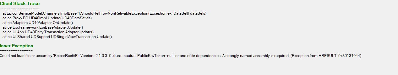

I am trying to use Epicor Rest to call a BAQ in an external dll. I have downloaded the EpicorRestAPI nuget package successfully and created the parameters and call for a BAQ. This gave no compile errors. When I went to run a BPM which calls the method in which the rest call is located I get this error:
I noticed that the assembly in my project references has the “Strong name” property to false.
Does this need to be true? If so, how do i accomplish that?

What the error is saying is that our helper Dll is not strongly signed (it isn’t) but Epicor wants it to be (that shouldn’t be the case) so I suspect there’s something weird with your setup
Maybe the consultant strongly signed his external DLL?

Yes I believe you are right. I think our custom dlls are strongly signed which is causing this error. I was trying to test the functionality of the rest call with a BPM to see how it worked cause i saw your video online and got curious. I see your point that if I am using a BPM to do that i might as well use the BO to call the BAQ (which I will most likely do or use an Epicor function).
