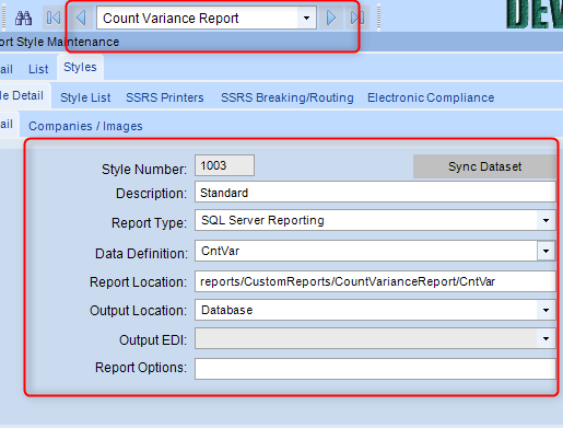

I’m having hard time finding Epicor Report on the Main Menu when looking through Report Style. Is there an easy way to search this? Thanks

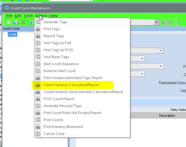

I do not believe that report is available from the main menu. I think you need to be in one of the cycle count screens to access it.
Thanks John! but how do you that? base on your experience ?
Some reports like the one pointed out, are launched from the form the are specific to.
The is no “Order Acknowledgment” report menu to print an order out. You have to be in Order Entry or Order Tracker.
Launch Cycle Count, load the cycle (or Physical Inventory). If you’ve entered counts, you should see the option from the Actions menu.
