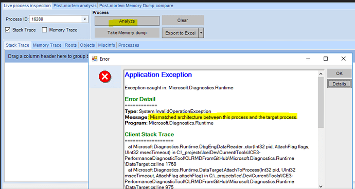

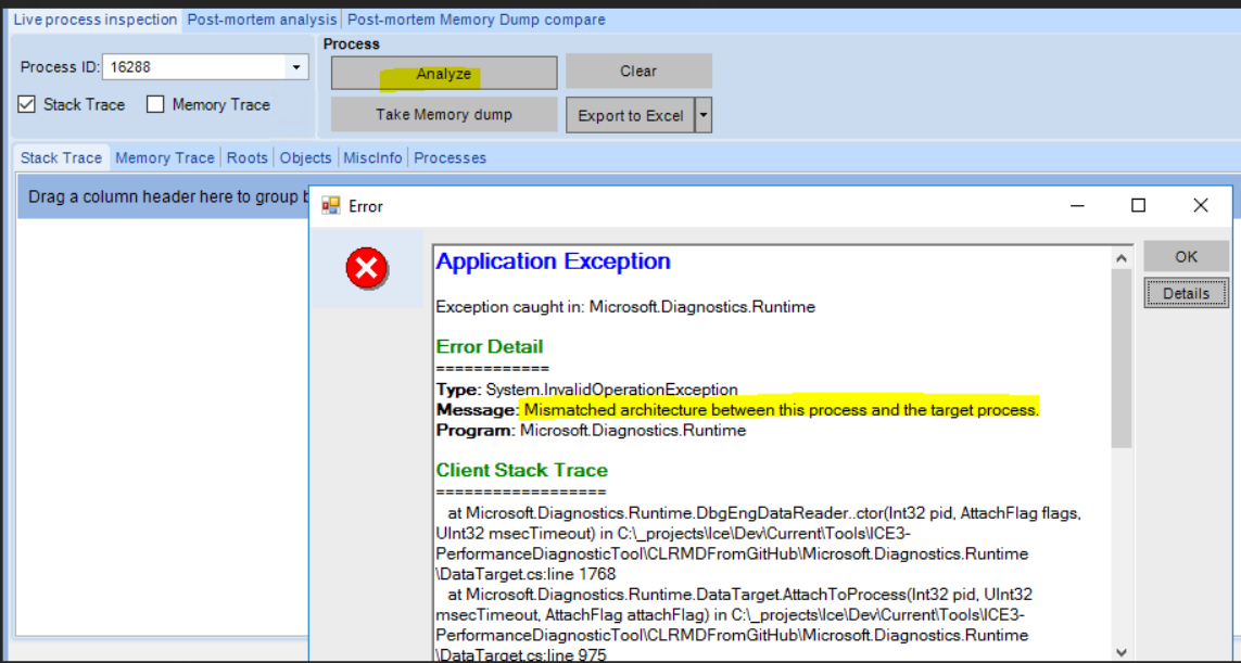

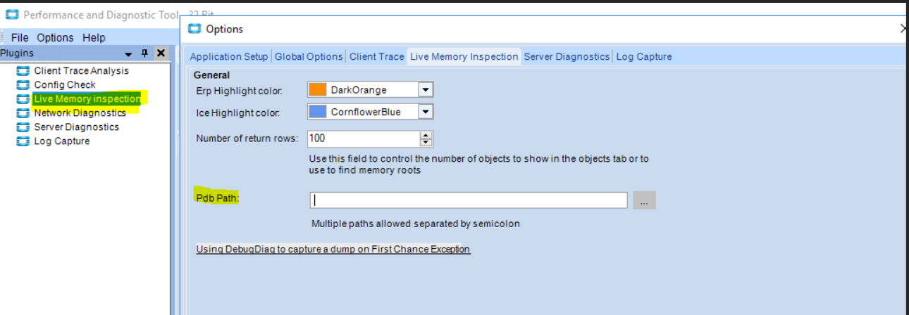

While running the Live memory inspection using Epicor Performance tool, we need to know what will be the PDB path ?
we tried to enter the path for client folder and analysising getting the below error.
please assist on the error and the pdb path
Thank You in advance.

Did you install the right version of the tool?
I want to say I got that same error a couple weeks ago and I had to re-install the correct PDT tool from the server.

Mismatched architecture, sounds like you tried to install the 64Bit version in a 32Bit environment, or vice versa (though WoW should have been able to take care of that).
