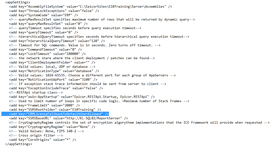

betwen appSetings and /appSetings
Hi Victor, i been install Epicor mobile CRM, I can see on my phone (Android) browser Rest epicor Page but i can not connect this app whit Epicor server, can you tell me how did you do?
