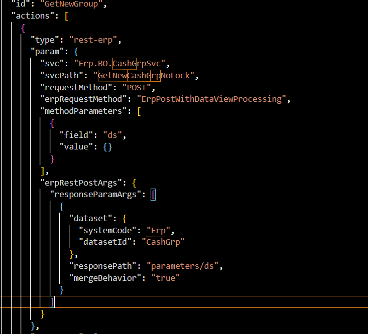

I am trying to create a new record in the CashGrp table using REST-ERP call
Everything looks okay but I am stuck saving the dataset in custom View from Response parameters. I have tried all combinations but have not been able to find the correct way to fill it.
I have also tried adding following things but no luck:
Parse from Response Path: returnObj or parameters or ds (nothing works for me)
Can anyone confirm for me how to find the correct way to input response parameters?
This is what I found in MetaUI:
appreciate your help
Parameter Name is going to be the table name from the dataset.
View Name is your DataView in App Studio.
Parse from Response Path needs to be returnObj. Seems CashGrp is different. This needs to be parameters/ds.
Typically, follow what’s in the network’s response:
90% of the time, that’s returnObj.
thanks Hannah. I did the same but it didn’t work. Just want to mention, I am creating new record in CashGrp.
Remove this:
Did you put anything in here? If so, that botches the widget and you’ll have to delete it and recreate it. Don’t touch that property.
*Changed my DataView name to be “CashGroupView” to make it less ambiguous.
The rest of it:
Thanks, Hannah,
I find this one is the culprit. Thanks again :slight_smile:

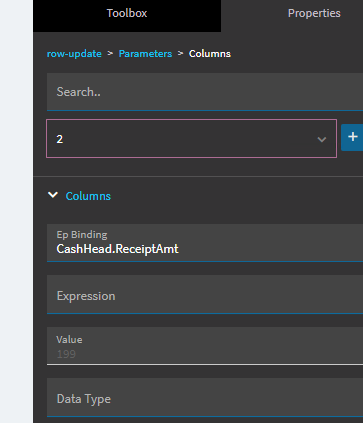

Second Step: row-update (These are required fields)

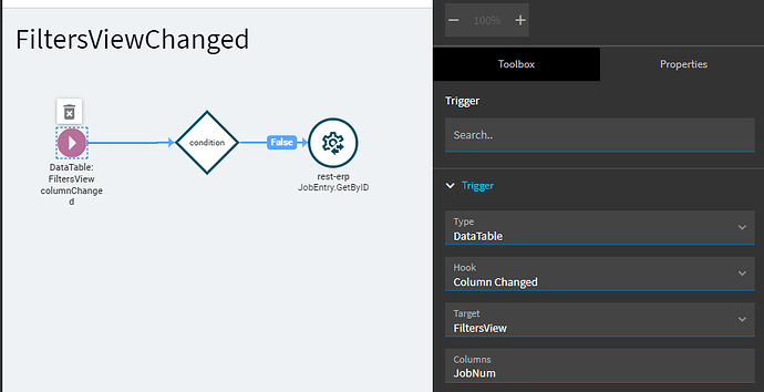

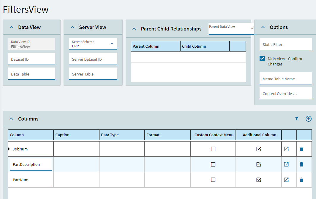

I have a view called FiltersView and it has 3 columns (JobNum, PartNum and PartDesctiption)
Then I created an event which trigger at FiltersView.JobNum changed
Inside there is condition and erp-rest widget. Let’s skip the condition in discussion as it is not important here (assume it is always false). My goal is to call Erp.BO.JobEntrySvc and map PartNum and PartDescription from response to FiltersView.PartNum and FiltersView.PartDescription.
I have tried to setup widget in different ways described in this topic but it seems not to be working for me. Have anyone been doing such thing?
I know that I can map part of the response to DataView but here I would like to map specific response value to specific DataView column directly. Is this even possible with this widget?
