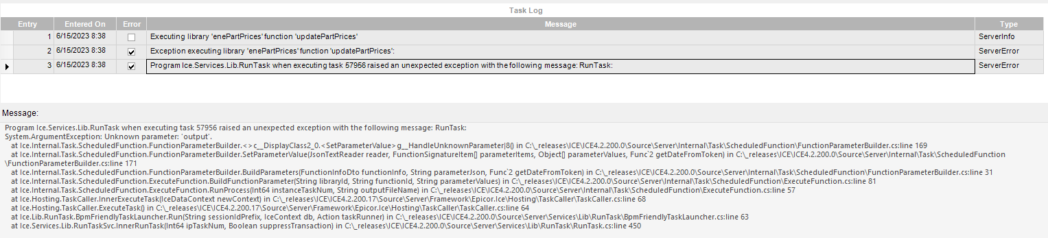

When I try to schedule the function, it asks me to fill in the parameters (including the response parameters) but when it tries to run it errors out. This occurs whether I leave the response parameters empty or give them a dummy value on the scheduling form.
