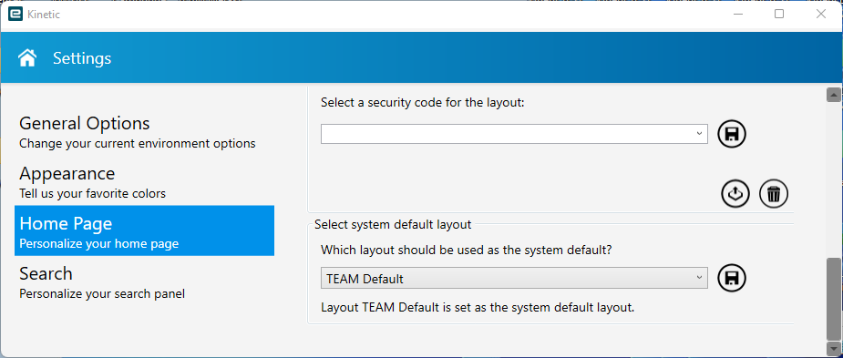

I fixed it myself and assigned it to the users I setup.
I have attached it for your use.

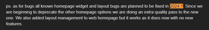

I seem to recall that the Home Page is getting a lift anyway.
I’m sure it will at some point… when they give us a date and the actual fixes I’ll stop bugging them… but as @LarsonSolutions says, as a world-class software company this kind of thing going on for this long is inexcusable.

CR of 2024.1 I’m not seeing any major changes to the home page. The colors are shifted and the fonts are different. We can reorder the tabs now. Other than that not seeing the major changes that were discussed in that thread unless I am missing something.
We have our own layout we designed ourselves so don’t care too much about the shortcuts on the default layout being broken. Really would have been better for Epicor to just give everyone a blank slate to start with imo and avoid the whole headache. The root of the problem is that the security is tied to the menu hierarchy instead of the program itself. If the security were on the program it shouldn’t matter where in the menu the shortcut points to.

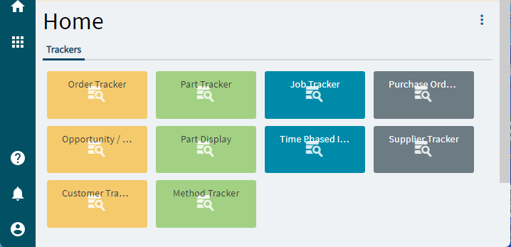

The reason for this is because Epicor changed the way security works in one of the early version of Kinetic. If somehow you have a link to menu item on your home screen that is linked to a location you don’t have access to, like on the default home screen, now when you try to open it checks to see if you also have access to the parent menu. When this change happened I had a lot of users who had to recreate some of their home screen links on both the Kinetic and Modern home screens. I created a new default Kinetic home screen with just some basic trackers from Executive Analysis, which everyone has access to with how we have security setup, so I quit getting these complaints from the default home screen.
