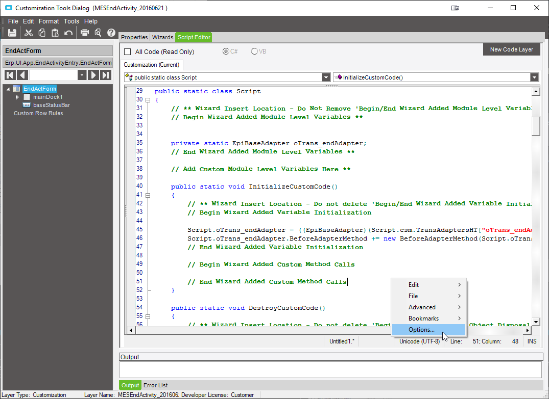

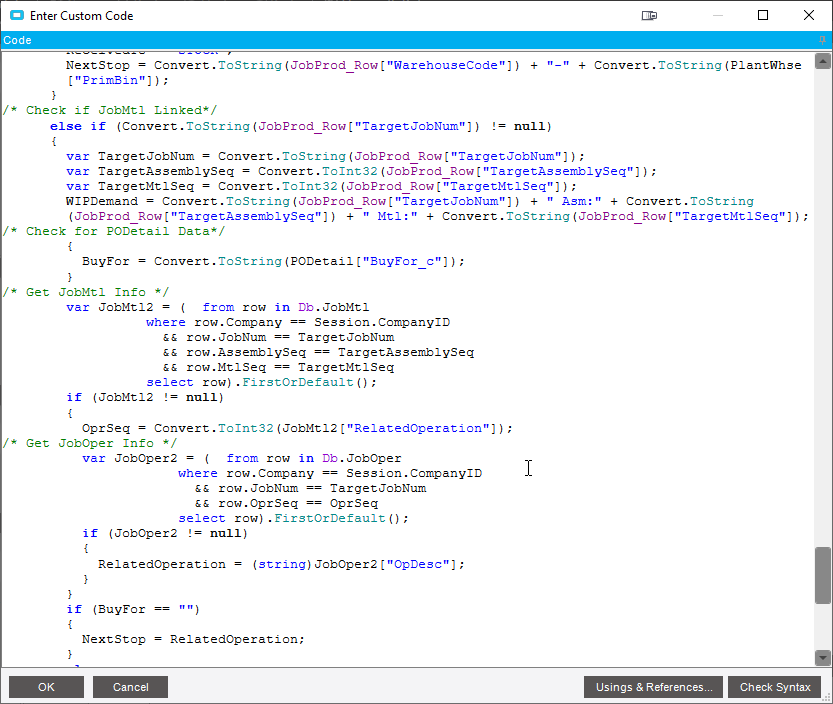

After switching between different projects today, I noticed there is a lack of consistency in code editors within Epicor and it was starting to drive me crazy! Does one software program really need to have 3 different C# code editors, that all work differently?
Screen Customizations - has line number and a bunch of other options
Could we take the benefits of each and combine them into one really nice editor? PLEASE?!? In the meantime, Iāll continue to code in Notepad ++ and Copy & Paste I guessā¦

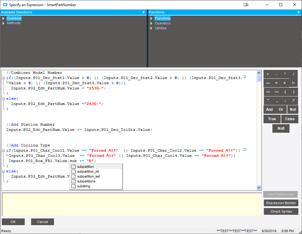

Note that I feel your pain (and your rant)ā¦ I did a similar rant when I found out that BPMs supported the ānewā String interpolation command for formatting stringsā¦ but the Configurator does notā¦
Turns out that BPMs have been converted to use a Roslyn platform for C# code, but the Configurator is still using CSharpCodeProvider to generate code, and that doesnt support C# 6 (yet?)ā¦ I was told that the tools team is looking into this, but it will take some work to make the code platforms unified.
I had been doing a bunch of BPMs, when i found the string interpolation optionā¦ then I went back to Configurator, and was disappointedā¦ it is really much more readable: (which do you like best?):
//OLD Style:
string st = String.Format("part: {0}, Description: {1}",MyPart,MyDescription);
//NEW IMPROVED style:
string st = $"part: {MyPart}, Description: {MyDescription}";
I feel your pain, For what its worth, you can click the tab on the errors window of customization editor and double click those errors to get to the offending line.
