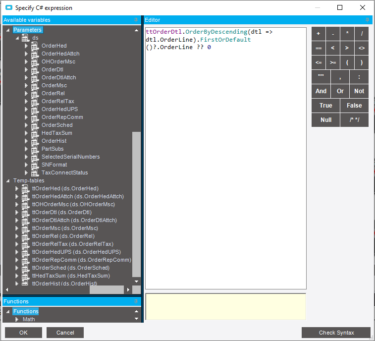

Working on a BPM and had some help earlier but seems to have diminished as it is bedtime here on the East Coast. I am hoping there are some on the West Coast still up that might help me out. In the picture below you can see on the left there is a temp table section and a ds section. The code shown works on the temp table section and I am wanting to get it working for the ds table section. My interpretation is that there is a difference in the ds tables and temp tables. I am looking for some help to get the highest value in the orderline field so that it only returns one record. When entering orders in through DMT I am able to get the bpm to fire but returns a null reference. I am guessing (hoping) using the ds tables there will not be null values.
Anyway thanks in advance as I have been working on this BPM for days and have to deliver this coming Monday but concerned I have run out of time. Willing to get help for whatever it takes as I am in dire need.
Well I got it to work but still got the same results of null reference when using DMT so still on the path of figuring out why DMT throws a null exception but works fine just adding a new line through epicor.
The syntax was
ds.OrderDtl.OrderByDescending(dtl => dtl.OrderLine).FirstOrDefault()?.OrderLine ?? 0
