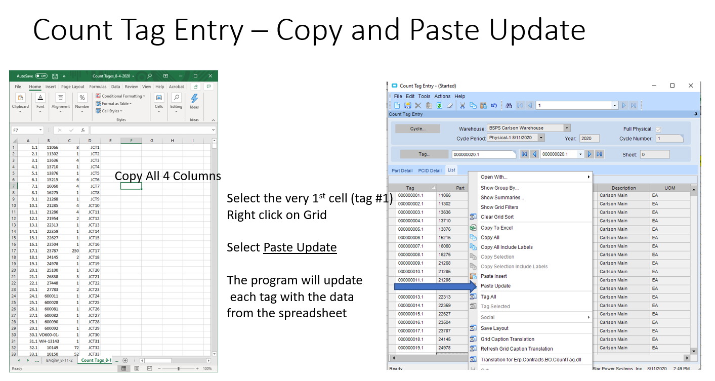

Just want to know if anyone can provide the cycle count steps.
currently, I only can add part one by one into cycle count. we have more than 24k parts to be counted. Maybe my step is not right. so, if anyone can provide the cycle count step, appreciated !

You can export your tags to excel and then paste update back in. DMT might also work.
thanks a lot,
Make sure you do a lot of testing. Sorting order matters. And the Data you extract needs to match the data you input back in. Good way to test is to copy out the count data and dump it back in so you balance $0.00 on your variance.
Symbols and Hard Returns in your part descriptions might cause the part numbers to jump, which is why copying the same data in and out will be a good test.

Also a sidebar - They did finally make a DMT for Count Tag Entry. I know it didn’t always exist, but I used it in June.
really, good to know. if they have DMT, it is good.
thanks so much, i will use this method for now. For DMT, i will ask Epicor. I know in old Epicor 10.1. we don’t have DMT available.
If you are planning to do full Physical, then you can use Initialize Physical Inventory option which will create Cycle for all parts under selected warehouse.
thanks a lot, i will try that.
