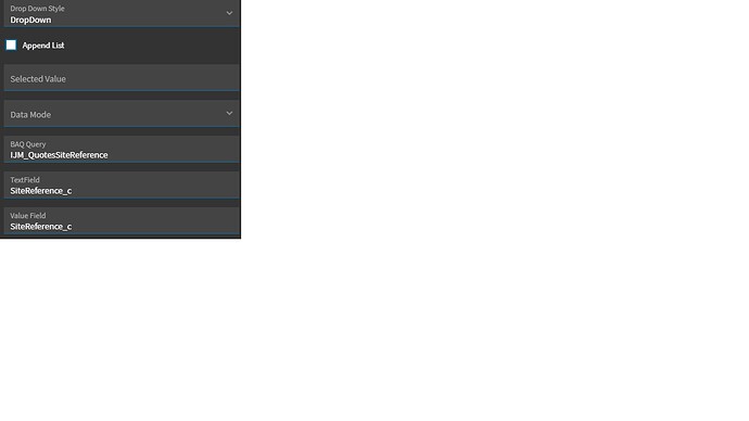

Have a BAQ combo box bound to a UD field in 10.2.500 returning data no problem but when I do the same in App studio I’m getting no data … any ideas. (BAQ itself is working fine)

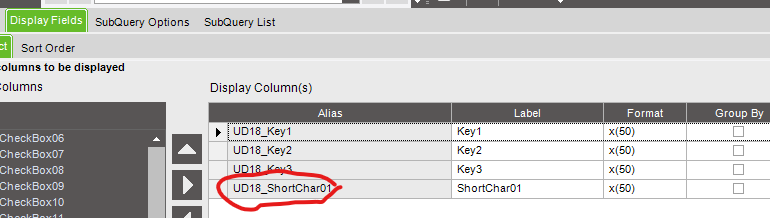

I think maybe you text and value need to be set from the ‘Alias’ column in your query
for example I have a BAQ on UD18 and I use
“UD18_Key2” for value and “UD18_ShortChar01” for text
get those from your query here:
(Although my Combo is still not loading the data, lol)
