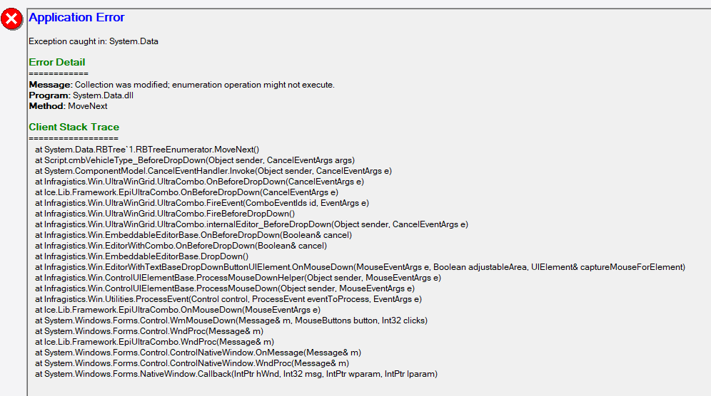

@Chris_Conn - I tried to use this and it works, but only after I clear two errors when clicking the drop-down arrow… incidentally, there are 2 items getting filtered out of the list. Is there a bit somewhere else I need to add to make it happy?
I dont believe you used the code above. Based on the error you got, you used a foreach() instead of a for()
You’re exactly correct. I did change it to a foreach. I didn’t realize that would affect anything. Everything affects something, I guess.
Any time you use a foreach, you cannot add or delete from that collection as you are iterating
