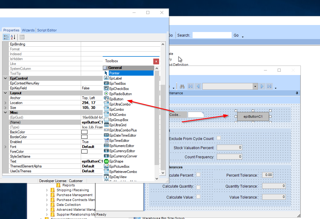

I want to put an EpiButton on a dashboard in the tracker view that when you click it, it displays a message.
So basically I’ll name the button “Tips”, users will click it and a message will popup with all the tips for the dashboard.

Check out this post, it has more information than you need, but I think if you take that basic code and strip out all of the extra stuff and hardcode your message into the message box, you can get it to work. It’s not formatted nicely, but it should be able to serve your purpose. You will have to do this is an assembly dashboard (you have to deploy it) and then customize that to get this to work. (I’m pretty sure.) I’m sure @Chris_Conn will come by and show you how.
That would be how to get to the runtime, from there you need to deploy the dashboard, then add it to the menu (see screen shot and follow instructions to deploy, do you know how to add menu items?). Then you customize it there using developer mode, (like you would an existing menu). Adding the custom code in the run time version won’t work right. I wouldn’t even put the button on the tracker until after it’s been deployed and added to the menu.
That;s the definition of an event - it still has to be attached to something. Did you use the wizard to create the click event for the button? If so you should see something like:
Just an assumption - did you happen to add that button BEFORE deploying it? If so you probably can’t modify - Epicor will take ownership.

Aah alright so that’s why when I deployed the dashboard I wasn’t able to add an event wizard on that button… I’ll try deleting the button on the “runtime” and then add it to the customization instead.
