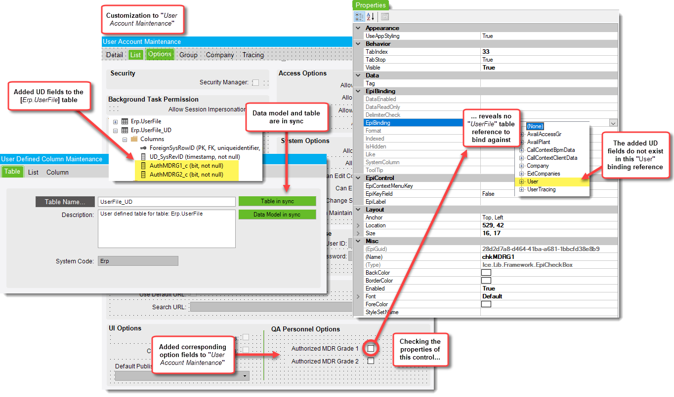

Greetings to all.
I am working on a small customization to the “User Account Maintenance” module, whereby two checkboxes are being added that correspond with two UD fields in the [Erp.UserFile] table. I need to bind the checkbox controls back to the established UD fields. However, upon checking the control properties, there does not seem to be a binding reference available for the added UD fields.
Here’s a quick depiction:
Might anyone recognize where I might be going wrong in this example?

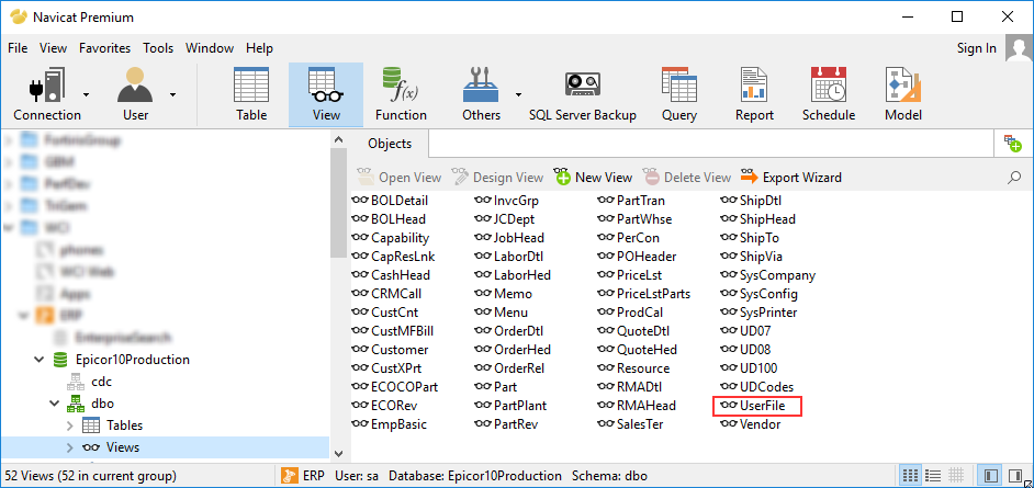

You should see it in the views if all went well
You are correct. I see it there in the SQL view.
However, going back to the “ EpiBinding ” in the checkbox control properties, that property contains no binding reference for “ UserFile ”.
The reason I believe I need to target the [ Erp.UserFile ] table is because I performed a quick test edit on my own Epicor user account using “ User Account Maintenance ” and the results were visible on the corresponding user record within that table.

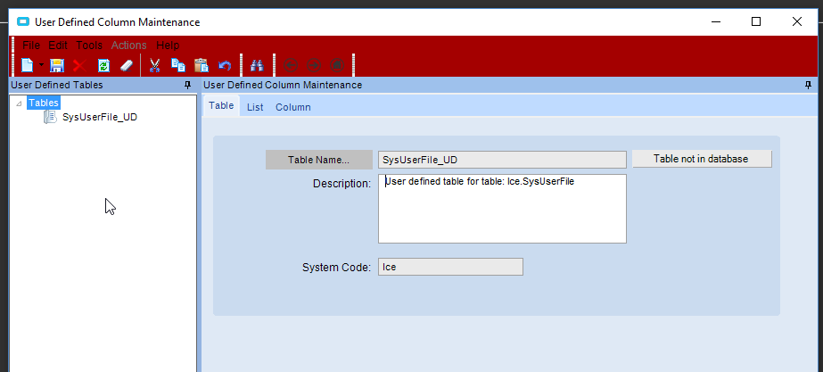

@josecgomez:

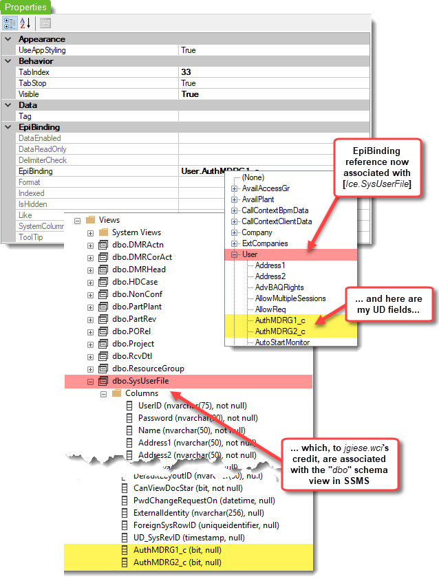

I set up my UD fields on the [Ice.SysUserFile] table instead of the original [Erp.UserFile] table and sure enough, the EpiBinding reference contained the UD fields as defined.
To @jgiese.wci’s credit, SSMS maintains the view in the “dbo” schema, as he had previously suggested that I check.
Updated results here:

If I recall, yes. I created the UD fields on the [ Ice.SysUserFile ] table, which were merely “bit” (boolean) fields to accommodate the checkboxes on the “User Account Maintenance” form.
