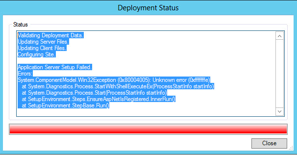

Ensure IIS user has file access (10.2.300.3)
Latest version 10.2.300.3. I have built numerous sites on this Server and never got this error.
IIS_File_Access
EnsureAspNetIsRegistered_Error
My only workaround was to use my own Windows Account and give me “Full Control” permissions to the C:\inetpub\wwwroot folder.
I followed this article, but it did not work:
(iis - IIS_IUSRS and IUSR permissions in IIS8 - Stack Overflow)

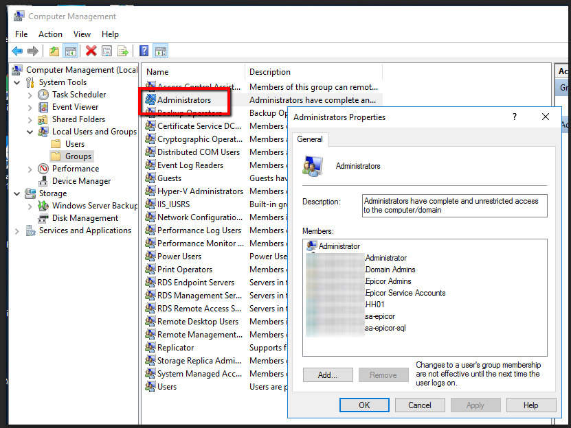

I didn’t have any of these issue(s) fortunately… I also rebuilt the site literally 20 times on Windows 2012 and Windows 2016. I also installed it to C:\inetpub and D:\Websites (custom folder) without a problem.
I also did it under a User that has Local Admin Privileges. I also used the Custom Account option in the App Server config and pointed it to sa-epicor (service account)
It is actually a simple issue as this happened to me as well. It mean when you started the EpicorAdmin Console, you did not start it with elevated privileges. Just right-click and choose “Run as administrator” when opening the admin console. This issue will be no more
