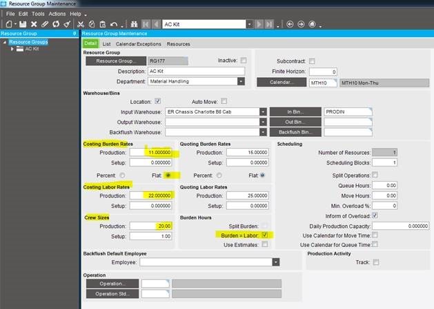

  1. Production Management > Engineering > Setup > Resource Group
    a. Define a resource group with Costing Labor Rate of $22 & Costing Burden rate of $11 (flat). Resources use Group Values.
    i. Burden = Labor
2 Production Management > Engineering > General Operations > Engineering Workbench
a. Create a MoM with one operation & one resource group.
i. Set Crew Size to 30
b. Set the Prod Std to 1 hr/piece

iii. When you open Actions > View Costs, the problem appears. The standard burden total cost is only 1 hr x the burden rate when in fact, the actual labor entries will apply an hr of burden for each hr of employees logged into the job. In our case, we have predicted in the MoM that 30 people will log into the operation. If they log in for an hour each, as the production standard predicts, at $22/hr actual employee rate, their actual labor applied will be in line with the standard labor cost, however the burden will be 30 x 1 hr employees x $11/hr burden rate (total actual = $330), which is off from the standard burden cost by 29 times.

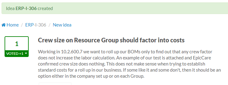

This seems like pretty standard stuff from my 20 years in mfg and I cannot believe it has not been addressed yet in Epicor. I am going to reference your enhancement request in mine. Anybody else willing to get on board with a request or if you have a workaround please respond.
Enhancements are on the new idea page now…please go up-vote if you agree!
