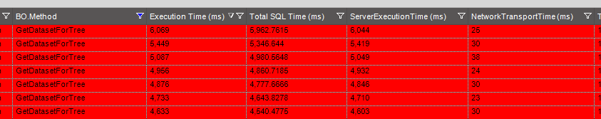

Over the last few months my users have started complaining about the slowness of the engineering workbench, specifically adding new parts. Nothing else has been affected so at first I thought it was just their perception, but I also started feeling it with much slower DMT changes to the BOMs, slowing down to a crawl. Upon investigation, there’s a couple methods that seem to be really slow. GetDatasetForTree goes from taking a few milliseconds to almost 10 seconds by the time all the parts have been added. And we only have about 30/40 parts in our BOMs, so I don’t think that’s something extraordinary. Checking it in at the end is also taking about 10 seconds.
Our BOMs have not changed much at all, number of parts is always about the same so there’s no reason why it started slowing down so much. My only ideas are that our product is made to order with not many repeats so we do have thousands of manufactured parts and BOMs, but that really shouldn’t interfere with speed of each individual one. The trace files are showing almost all that time is spent on the SQL processing, so that led me to look at the EcoMtl and PartMtl tables. We have a bit over 1 million rows on EcoMtl and a bit less than half that on PartMtl. Now I’m not 100% sure if those EcoMtl rows should be there, I had the idea that those should be cleared once the BOM is approved and checked in and transferred to the PartMtl table. We do create BOMs using some custom code so I’m wondering if there’s some cleanup that isn’t being done that is causing this.

So I created a new ECO Group, created a new revision and pasted in almost 50 parts from a different BOM. First instance of GetDatasetForTree ran in 276ms while the last one was over 6 seconds. Each new material coming in takes longer and longer.

This to me points towards a missing or corrupted index in the database. First, make sure you have suitable indexes on all key fields in those tables (Company, PartNum, JobNum, MtlSeq, etc). If everything looks fine, you can use the following SQL query to rebuild all indexes in the database. Make sure you first take a backup of the database, and do this only outside normal hours, as rebuilding indexes might take a while, and database performance will suffer while it is going on.

We had pretty much the same issue - this may be a bit too technical if you don’t have decent DBA skills or admin level access to your SQL DB, but we were able to find a query that was long-running whenever users were switching between, adding, etc. materials in Engineering workbench and then the SQL query optimizer suggested an index which we added and sped that process up immensely.

We are on 10.2.400.15 and slowness like this and it was related to attachments that are being verified as valid for the tree and a lot of them were not as server names had been changed. I used the attachment maintenance utility to change the paths that were incorrect.
