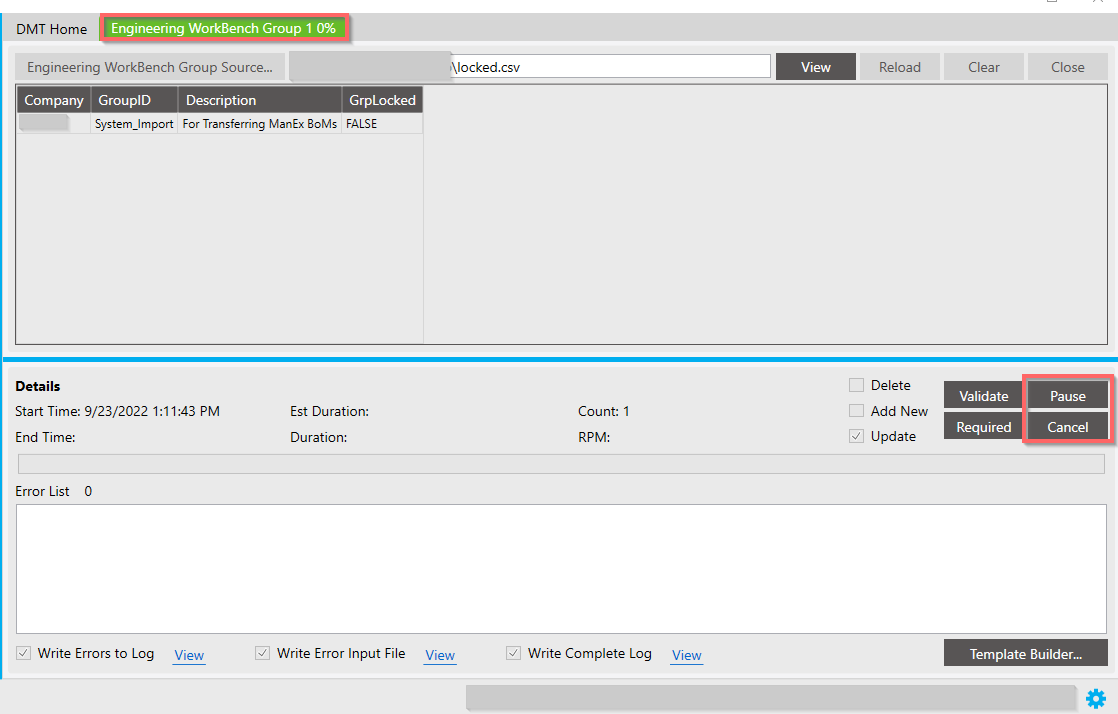

Have you tried unlocking it with DMT?

Good idea about trying DMT although it would be inconvenient if I always had to use it, however it surprisingly also sits running but never completes or errors on the record.

Hold up, I take that back. DMT did finally complete with an error after 9 minutes 55 seconds.
