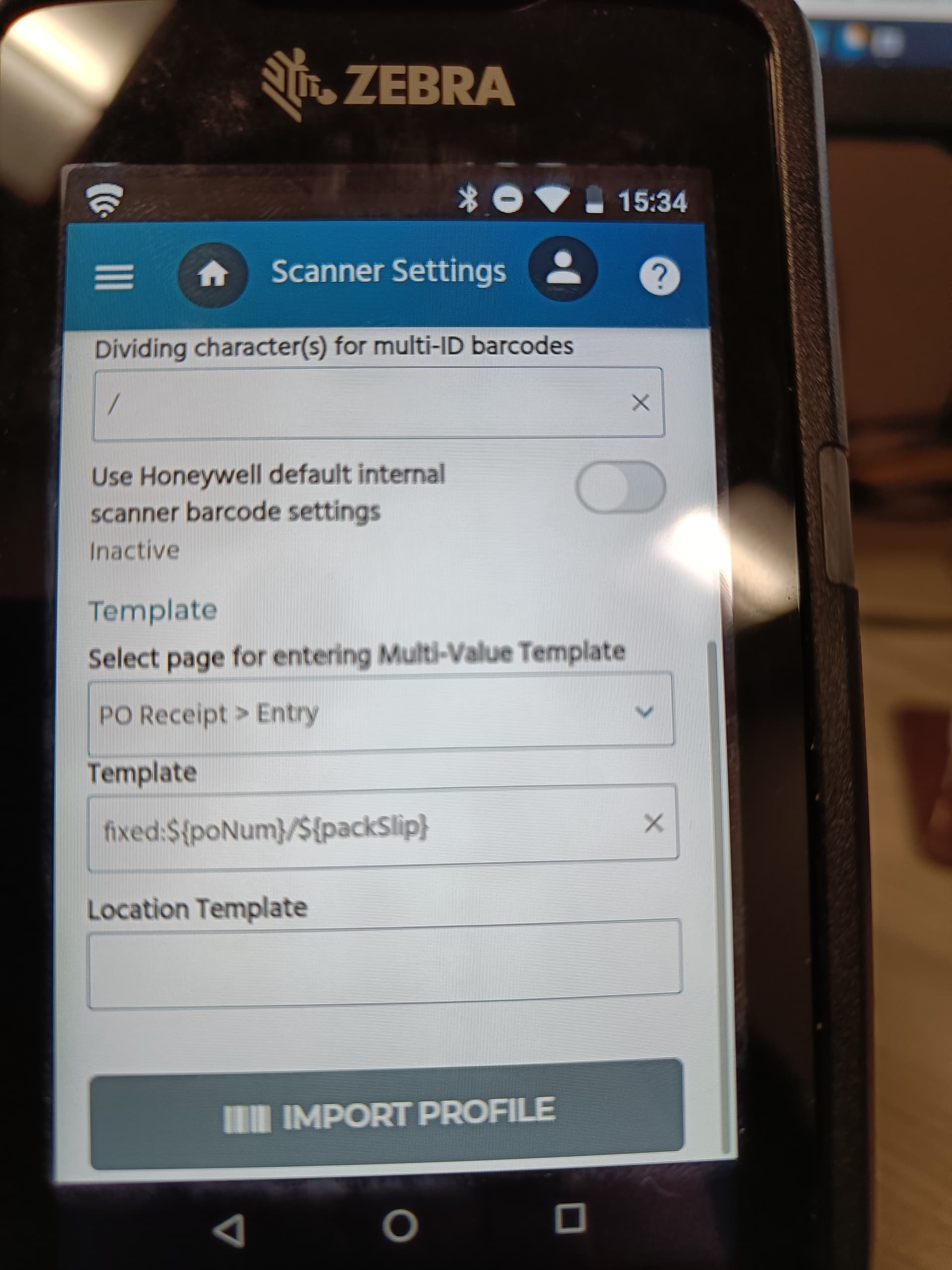

In Scanner settings for PO Receipt > Entry i have done this

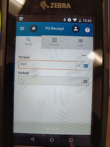

So now when i go to Receiving and PO Receipt and scan the barcode/QR code i get this

Based on your screenshot the issue may be that you are focused on the PO Num input.
For a template to scan you need to not be focused on a specific input when you scan. If you are focused, the application will interpret that you want exactly what you scanned to be filled into the input. When it is not focused, it will interpret it as a template.
The “Input field autofocus” setting if you have it enabled would be automatically focusing when you open a screen:
