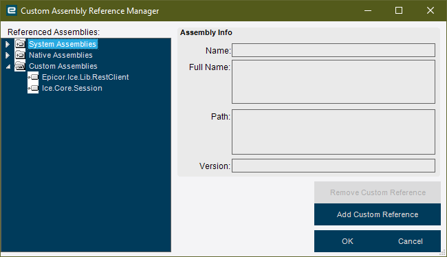

Calling REST from a Classic Customization
You need to bring in these helper DLLs
Execute a Function in the Client using Rest Helper
var _restClient = new RestClientBuilder().UseSession(oTrans.CoreSession).Build();
		var functionContent = new RestContent(new { iPhrase = "hey There" });
		var functionResponse = _restClient.Function.Post("FunFunction", "MyHelloFunction", functionContent, published: false);
		var functionResult = functionResponse.GetAnonymousResult(new { oSuccess = false, oMessage = ""  });
		if(!functionResult.oSuccess)
			MessageBox.Show(functionResult.oMessage);
