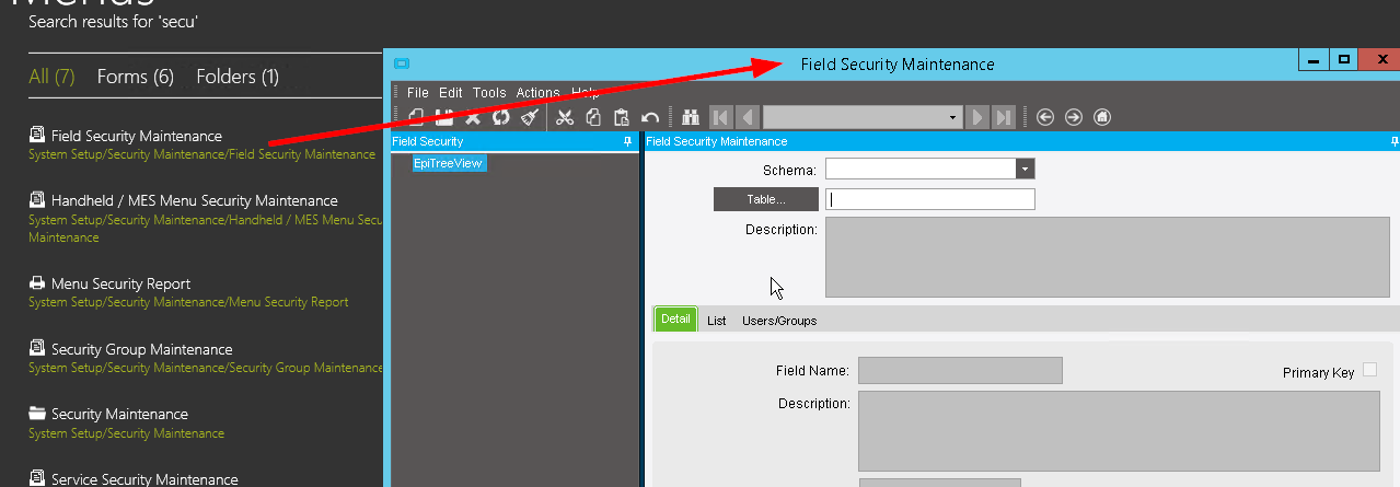

at
Did you or anyone mess with any field level security?
Should not have. I am looking in menu maintenance as we speak.
I didn’t. Had no idea that was there. lol

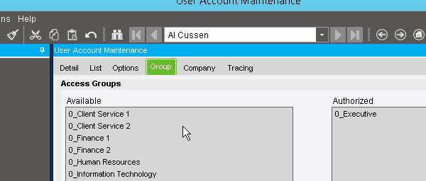

Are both users members of the same groups in User Account Maintenance?
Identical! this is frustrating. lol
