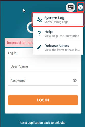

Yes, we are using self-sign certs. Three units have been working but when we added a new one, we got the error. (Old one on left, new one on right)
Here’s the System Log:
{“message”: “The platform configuration API failed, using default platform of EpicorERP and Username/Password authentication mode.”, “dateTime”: “2024-01-26T12:33:17.847Z”, “data”: {“headers”:{“normalizedNames”:{}, “lazyUpdate”:null,”headers”:{}}, “status”:0,”statusText”:”Unknown Error”,”url”:https://erpapp.pti/Production/api/.configuration?tenantId=,”ok”:false,”name”:”HttpErrorResponse”,”message”:”Http failure response for https://erpapp.pti/Production/api/.configuration?tenantId=:0 Unknown Error”,”error”:{isTrusted”:true}}, “type”:1}
