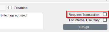

Hmm.
I noticed I had unintentionally checked this box:
The field help isn’t hooked up and I’m not interested enough to dig into the help to find out what it is.
