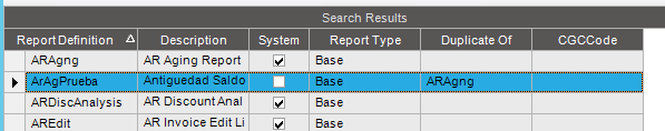

Please I need your help, we are editing a report and we are following the EpicorImplementation_UserGuide_101500 tab, and all the steps of the tab were done but when I go to SSRS to add the field in the report, in the dataset I do not see the table to continue With the process
This is how we define the data
But we note that in this part does not load

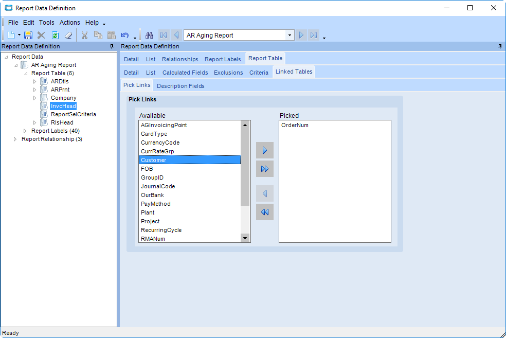

Instead of adding the Customer table to the RDD, Pick the Customer link from the Linked Tables on the InvcHead table:
Then Pick the fields for your report from the Description Fields tab:

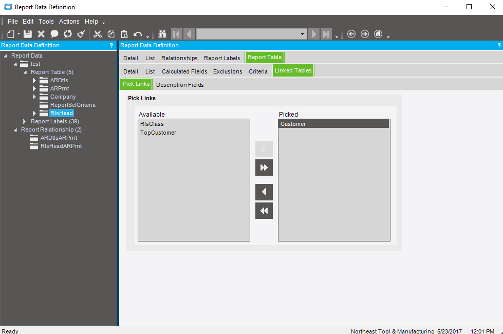

Here is how you can atleast get CustID and TerritoryID. Use this SQL code. You also need to make the following changes (pictures at bottom):

You also need to reference the fields in RDD. Go to RDD, select your report, on the left hand side under Report tables, click “RlsHead” and go to ReportTable>Linked Tables>Pick Links. From the list, select Customer to be on the picked side. Then go to ReportTable>Linked Tables>Description Fields. Select “Customer” in the pull down. Then find “CustID” and “TerritoryID” and select them to the right side.
Hope this helps!
